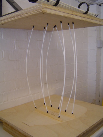

The best advice I can give if your making a go-bar set up is if at all possible use one attached to a wall using the underside of a sturdy (very sturdy) shelf or similar rather than the four support rods. I have had both types and the four support rods are a pain, they get in the way all the time.
This is my current one which I love to bits, I have clear access for attaching bars etc, it uses 1.5" of ply for the top which is attached to the wall with welded angle iron brackets.
If you mean to attach back and sides as well as gluing braces in the go-bar you'll need to be able to vary the height, the easiest way to do this is to use a raising block under the work.
I set the height of my top the thickness of my radius dish plus the depth of my guitar bodies and then reduce an inch. This means that when I glue on the top or back I have an inch flex in the rods. When bracing tops or backs I use a riser platform that the dish sits on so that I still have a gap of 23" between the top of the press and the material to be clamped, you can see the riser in the photo.

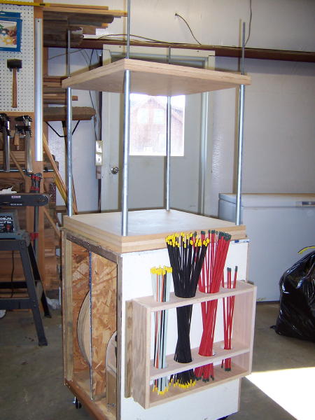

Peter, see what I mean? This is the tip of the iceberg where go-bar decks are concerned...it really depends on your shop space, what you want to do with it and how much money you want to spend. For the right amount of dollars "somebody" on here will build you a deck out of titanium.
Hesh's "spinnable" go-bar deck is awesome. I opted to do it a different way. Here's a photo of mine. It sits on top of a short, yard sale filing cabinet, which is on wheels. Go-bar rods are stored in the cabinet which, of course, spins are I need it to. I'm able to sit in a chair, use the deck when I want, and spin it to me, etc. Also, it rolls out of the shop to a different storage area when not in use...and back into the shop when I want.

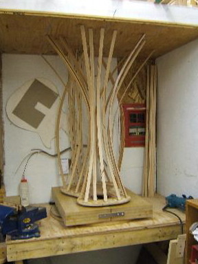

IF I had the room, I would have a deck in the middle of the shop that I could walk around like Jeff Traugott's set up. This picture is off Frank Fords website.

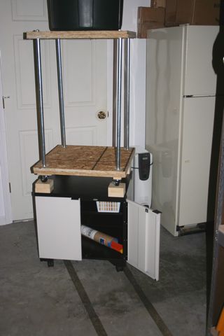

I made a roll around base for mine:
My top is about 24" from the base. That works well for gluing braces. For attaching the top and back, I just made a set of shorter bars. Works great.

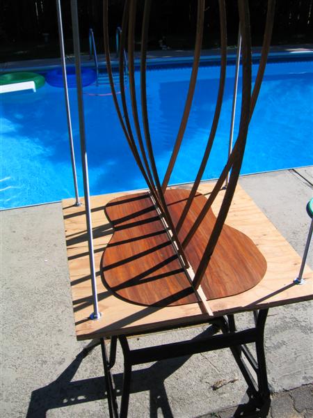

I made mine with 36" 3/8ths" threaded rods. It does wobble a bit the way it is but not much. Im using some cedar slats about 1/4" by 3/4" as I couldnt find any fiberglass rods locally and wanted to continue building. They might not be stiff enough for some operations but worked well for the braces.
